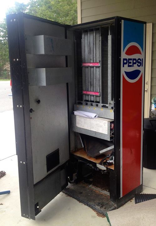

i have an older vendinh machine pepsi its 110 volts 3340 i think but i am not sure what to do, from the fron the orange lights are on but the little red display is blank does say anything or light up or nothing and then when i put coins in they drop right thru nickels dimes quarters they all go right thru and when i hinged and pulled accepter back thie red led light is not on i plugged it and unplugged it looked fine but still no light what do i do? and if i replace the coin chage the whole unit on ebay f0r 65 bucks will that help and does that have a main logic board in it or is that not in there / is it inside or a different part of the coin changer

someone please tell me if there is a fuse to get the front money display thing on and to make the red led light on in the accepter changer thing its off and coins fall right thru the coin changer and dont collect but all the lights in machine on the front work great and it keeps everything cold and i can push the red blue or white button and hold it and it will kick it slowly one at a time i got all the money out now it just falls right thru but it had money it at one time and they click and shoot coins out for coin removal does that mean i have power and the coin changer cant recognize coins? or why isnt my red led light on the little circle one and why doesnt the little front red display work
