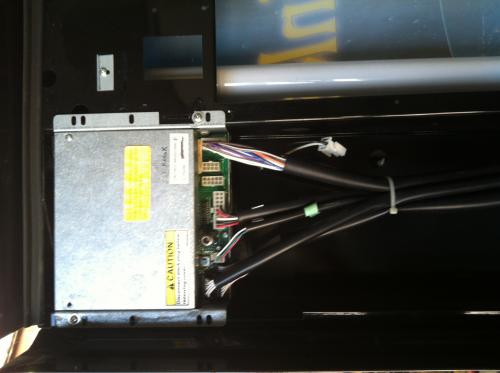

There are 3 types SII controller boards for Dixie-Narco soda vending machines. The connectors are different between an SIID (S2D) and an SIIDE (S2DE), I know because the connection ports are slightly different on S2DE (SIIDE) than on an S2D (SIID). As for an old SII or S2 I don't own one, so I am not much help there. Here is a picture of all 3 types of Dixie-Narco controller boards SII (S2), SIID (S2D), SIIDE (S2DE) with each one labeled.
Anyways I was out working on an SIID the other day and took some pics for you, they are the pictures below.
This one is with the board (SIID or S2D) in the machine with wiring harnesses plugged in to the board.
This next picture is of the wiring harnesses removed so you can each one.
Hope they help you some.
If you need more help just reply back on this post here and I'll be glad to help.

This is what I have
This is what I have
Last seen: 2 years 10 months ago
You have an S2DE
circello,
First off I made a small mistake and circled the wrong plug in the picture. I corrected the picture, the power plug is not showing but the arrow was/is pointing to the correct port for power in on an S2D (SIID). But you have an S2DE which is a little different.
It looks like you have got all your cables and are just missing your power cable. Before you go and buy a validator and coin mech, let's be sure you board is working, by finding the white power connector or buying a power cable.

I serviced a Dixie today with an S2DE in it and I have loaded a picture below with explanations. In your picture I see this little white plug and it looks like part of the power plug for your S2DE, I circled it here in your picture:
If you look in the picture of my S2DE (below), I drew an arrow to where it look like it connects. You appear to be missing the short plug, wire and P1 plug that connects it to the board power at (P1). You also appear to be missing the green wire (it is a ground wire, you can see it connects to the metal frame of the machine in my pic, easy to replace).
More importantly you are missing the 4 wires 2 red wires and 2 ?color? wires that also connect from P1 plug to a transformer (shown in your schematic), you might look look around that area and see if you can find a couple of red wires and 2 ?color? wires in a black wire wrap (see my pic)
Here is the plug/wire arrangment on an S2DE of mine with the white plug and a red arrow pointing to it:
