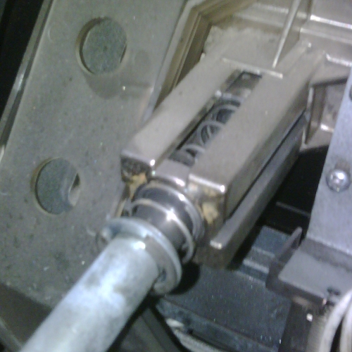

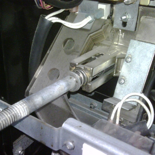

Someone put a drill into my old lock, so I had to take the entire T Handle ensemble out to get the defected lock out. I got my new lock and got it put in, but now I do not remember the order in which to put the springs, washers, clips, etc. in......Could someone please help?
This is a Dixie Narco, Model number DNCB 368/216-8.

Here are a couple of close-up
Here are a couple of close-up detailed pics of a dixie-narco t-handle in a machine (working fine). The view is from the backside of the door (inside the machine).
Hope they help,
FRANK
PS: These are as big as my camera will take and the forum limit here is 500x500. If you would like them full resolution (1200x1600),post a reply with your request and I will post a link in my reply.
Also feel free to download them and veiw them with windows. (right click > save picture as...)
