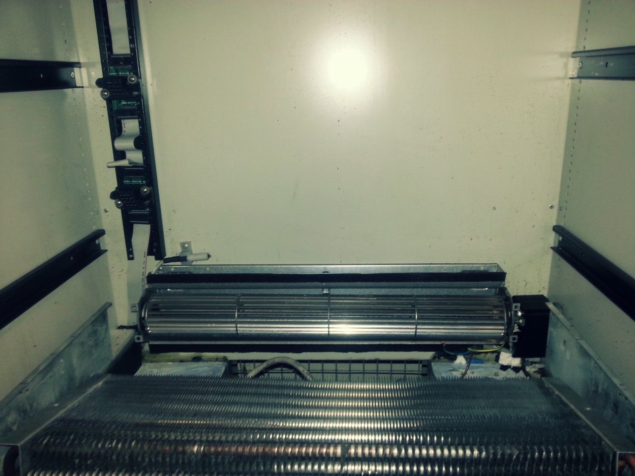

Me again. Does anyone nowhere I can get a fan for the same Manea vending i posted about earlier in the week. Im not near the machine at the moment but Ive got someone to measure it and they said its 560mm with the motor. Ive attached a photo. Im hoping this is the cause as to why my machine is not cooling and icing the compressor. If anyone can help me I would be thankful.

You may not need the whole fan and motor, if you disconnect the motor completely from the the fan and the fan will still turn freely, you might be able to buy just a motor or get that motor rebuilt. I have had to get a couple of old motors rebuilt that I couldn't buy any more. Electric motor repair shops can do pretty good sometimes. Just a thought.
