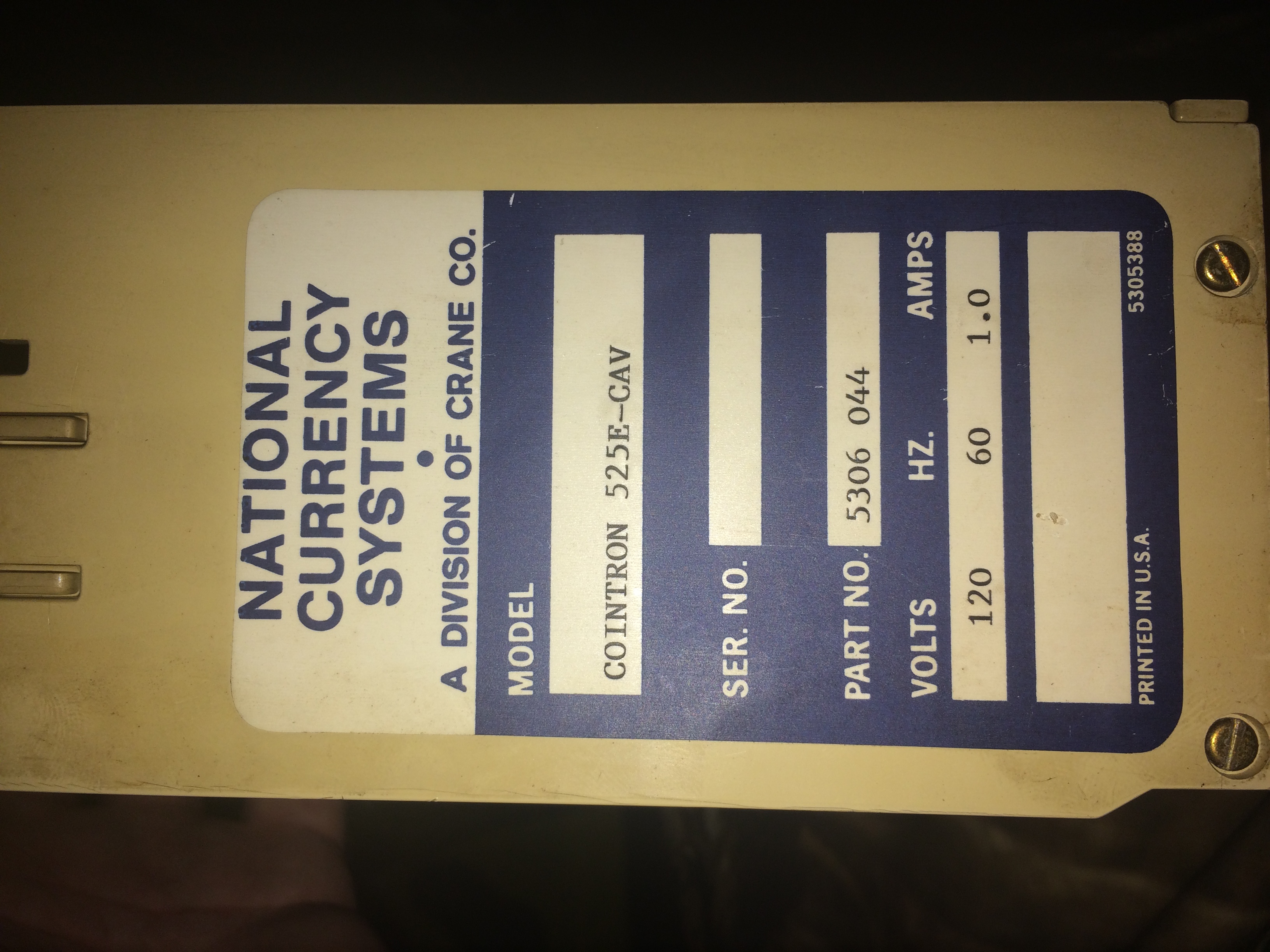

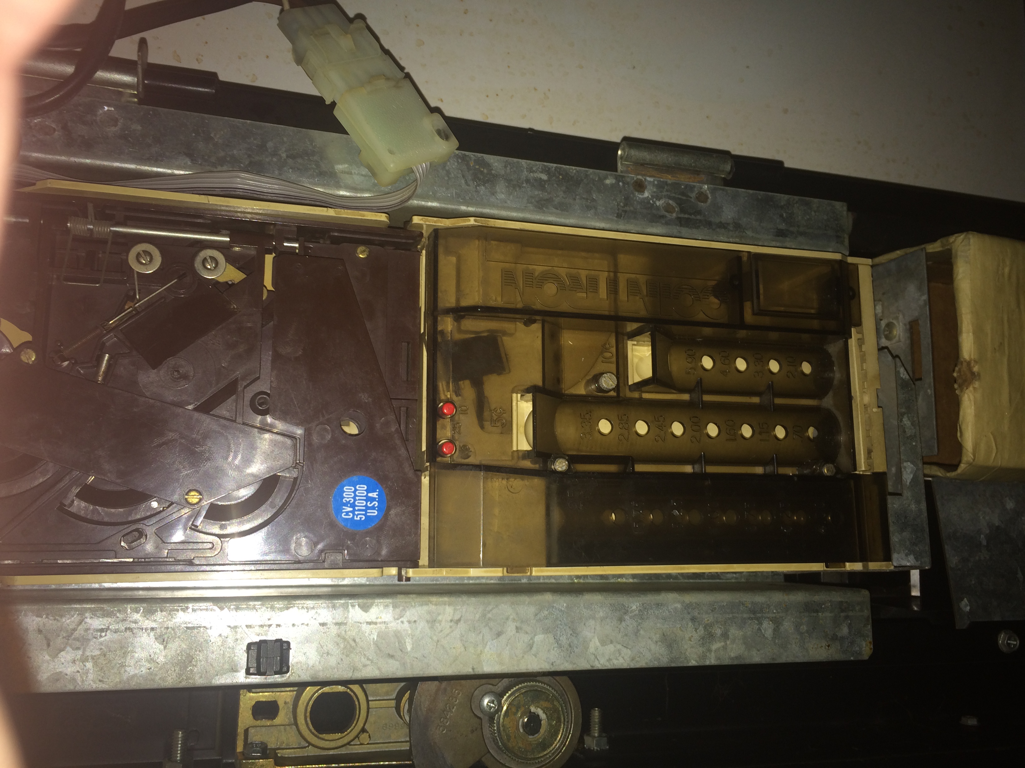

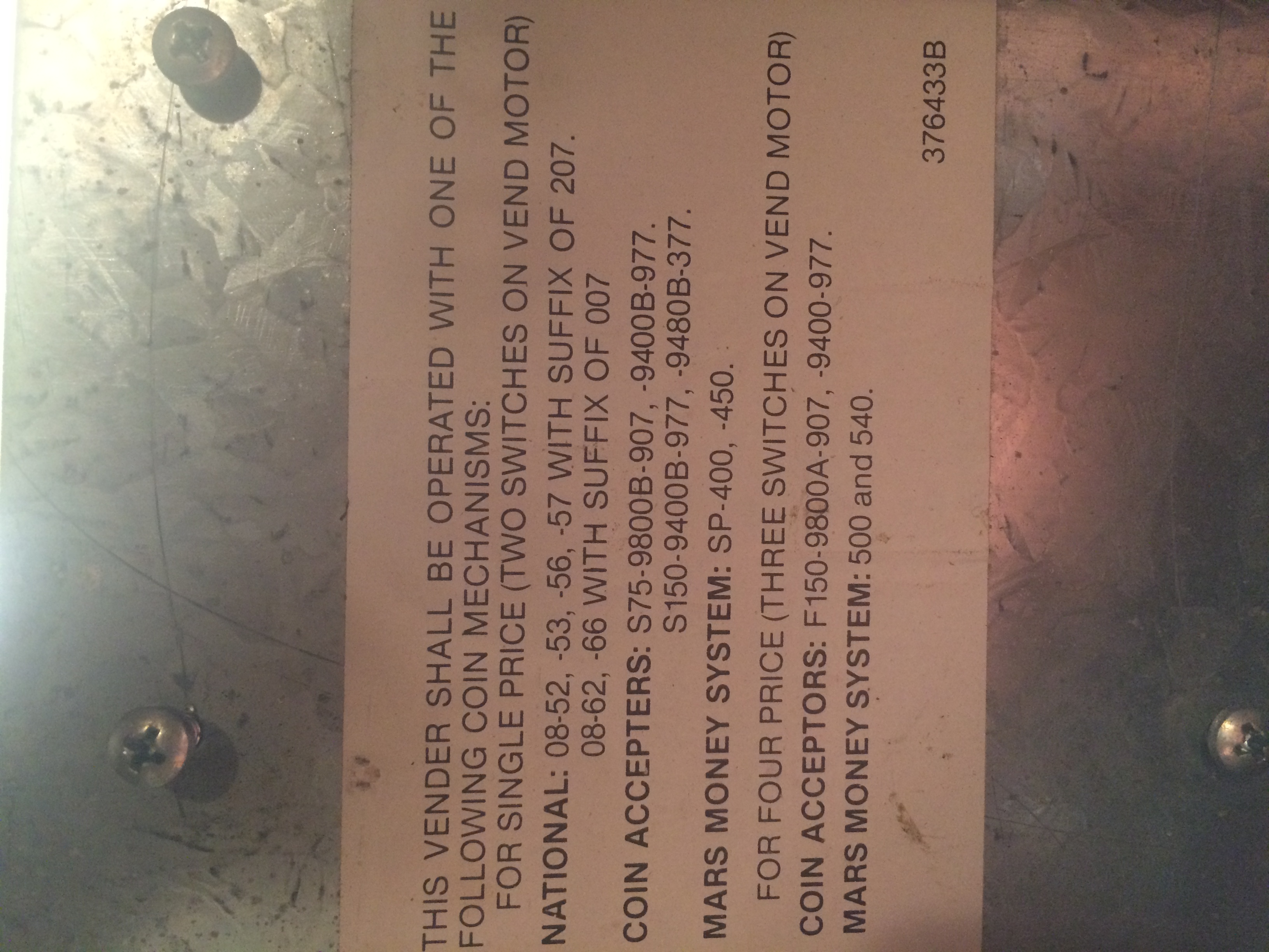

my coke machine has a coin mech which is a cointron 525e-cav, but isn't working. first I admit to having little to no knowledge on vending machines, so its my assumption that I need a coin mech and that the current one isn't working. so I need help fixing the machine or telling me where to get another coin mech, since my searches have gone unfavorable .
so its ice cold. but coins sometimes go straight to return and if they don't they just stay in coin mech till you press return button. whenever a selection is made nothing happens, not a click or motor, pop. dollar bill acceptor wont work either. vending machine is set to a nickel with change slots full and filled with soda. connections all seem tight with no damaged wires or taped /hack jobs.

Sorry to hear about your problem. Never seen your changer before. But I have some of the Coinco models listed on your label picture. Where are you located?

You may not need a coin mech, but if you do a Coinco 3340S 117v coin mech will work for your machine. They available all over the web.

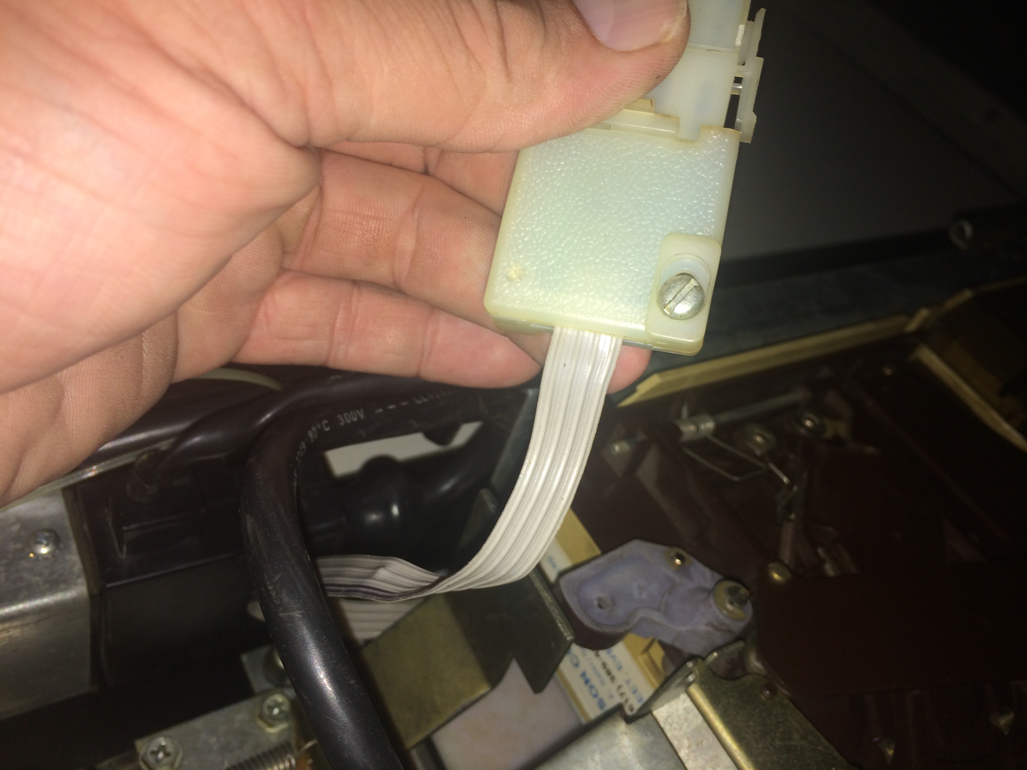

I am worried about the flat
I am worried about the flat four connector because no other coin mech has one. So how to plug that in ?
