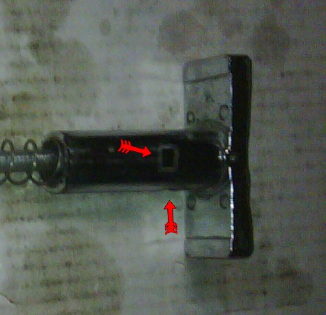

2 holes on a T-handle to set barrel lock "tongue" in.
str8rippin,
Your lock in the video looks like it is sticking out to far (it's in the wrong hole for that size barrel lock). There are 2 sizes of barrel locks (short and long) your lock should fit and work better in one of the 2 holes in the T-handle. First remove your lock (if you need help see this post: http://www.vend-resource.com/forum-topic/how-do-i-change-lock-my-soda-ve...), then look down inside the t-handle and you should see 2 holes, one is farther down in side of the T-handle and is 90 degrees off to one side from the other hole. I loaded up a picture of a T-handle out of a machine (see below) to help, the red arrows point to the locations of the holes. Sorry for the poor quality of the picture it's the only one I had on hand. Put your barrel lock back in and aim for the farther in hole. It may take you a couple of tries the first time, but you'll get it. It should seat better if not then you might have a wear/damage problem in the outer sleeve of the T-handle or your lock is bad. The lock you found on e-bay will work fine, I would try it in both holes and if that didn't fix your problem then your T-handle assembly is probably worn out/damaged. They are pretty easy to buy on the web for $15-$25. The above mentioned www.VendingMix.com will have them ask for Alex.

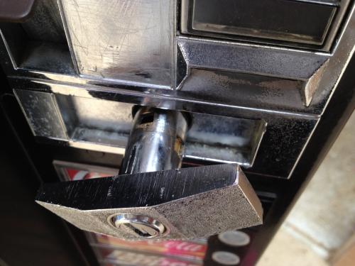

ok thanks so i pulled it out
ok thanks so i pulled it out and its too short to fit inside the other hole, i tried gridinging it down to the tab and it still wont fit, so i guess i need a new lock and i need the "longer one"
here's a piccy
